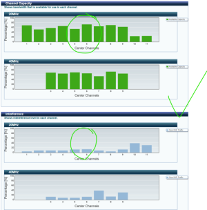

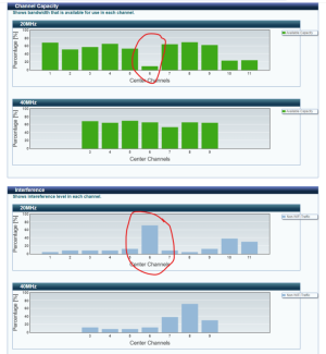

When I look at the Channel Statistics, I can see the graph spiking up and down for both (available capacity vs non-WiFi traffic. (pictures attached)
Is this a sign of the WiFi on the Router failing or something else? What else can I try?

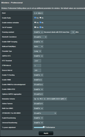

Change the channel to a fixed channel at 20mhz. 2.4GHz is very problematic with interference and will likely never work great unless your living in the woods.

Both active USB device in USB 3.x mode as well as WPA2/WPA3 with PMF required may cause issues with IoT devices.
I had your issue initially, and moved IoT clients to 2.4Ghz Guest Network. Use 2 or 3, not 1. Rolling along great now.
If you change the Authentication Method to WPA2-Personal option Disable will appear as well. WPA3 requires PMF.

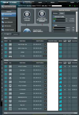

The only other devices I have that use 2.4GHz WiFi that are somewhat data hungry with transmission are:
-3 Ring Cameras
-3 Wyze Cams
-3 Eufy E330 cameras to HomeBase 3 which has its own wifi network. I also tried switching the Eufy homebase to Channel 1 so its not the same as Channel 6 (Asus Router)
I also have a Samsung Smartthings v2 Hub which is connected to a handful of zigbee sensors (door/window sensors, 2 Weiser door locks, 1 smart bulb)
If you change the Authentication Method to WPA2-Personal option Disabled will appear as well.
Thanks! Do you see value in downgrading it to WPA2 only? I curently have it on WPA2/WPA3. I am going to guess most of my 2.4GHz devices are old anyways and don't support WPA3.
I don't see any of your 2.4GHz clients capable of WPA3 anyway. They are perhaps 802.11n devices and there is no WPA3 there. Look at the Asus FAQ and my example settings. I cut off anything not needed, not used or used for marketing purposes only for both 2.4GHz and 5GHz bands.
