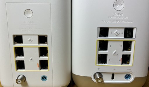

So I switched to the Xfinity internet provided XB8 (modem and router combo) from my owned Netgear CM1100. I got the XB8 activated and put it into bridge mode so it's supposed to just work as a modem at that point. I had planned to keep on using my Asus AX88U Pro to handle the router stuff but I can't get the Asus to work now. It powers on but the 2.5G light towards the middle that has the world looking symbol underneath it is a solid red. When I try and access the login site for the asus router it just brings up a welcome page and wants me to create a new network. It doesn't ask me to login to my existing network. I was under the impression that I could just log in and my old network settings would just work? Any idea whats going on here? I do notice when I have the XB8 hooked up directly to my desktop and run a speedtest it shows IPV6 now whereas before it would always show IPV4 with my old Netgear CM1100 modem.
