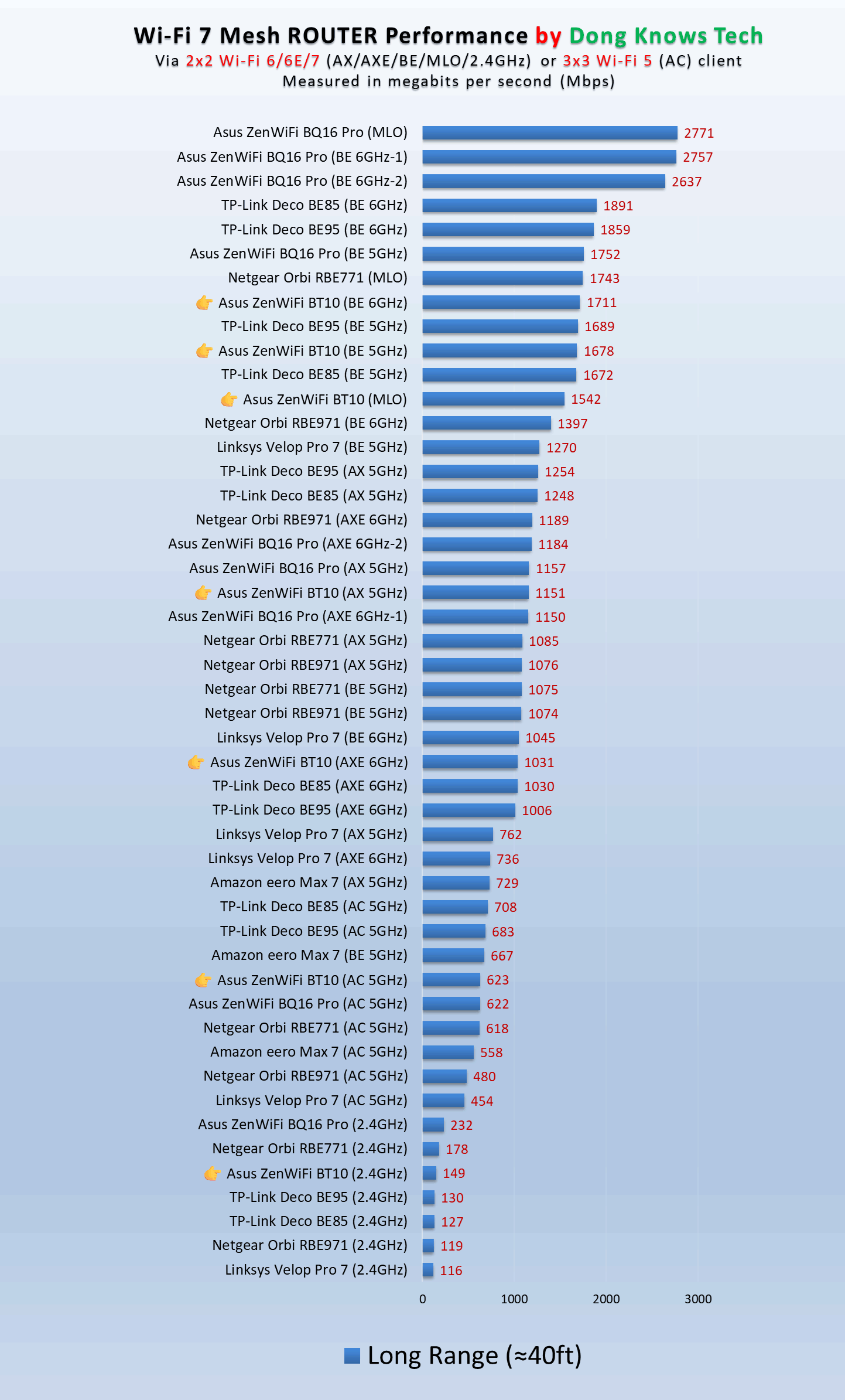

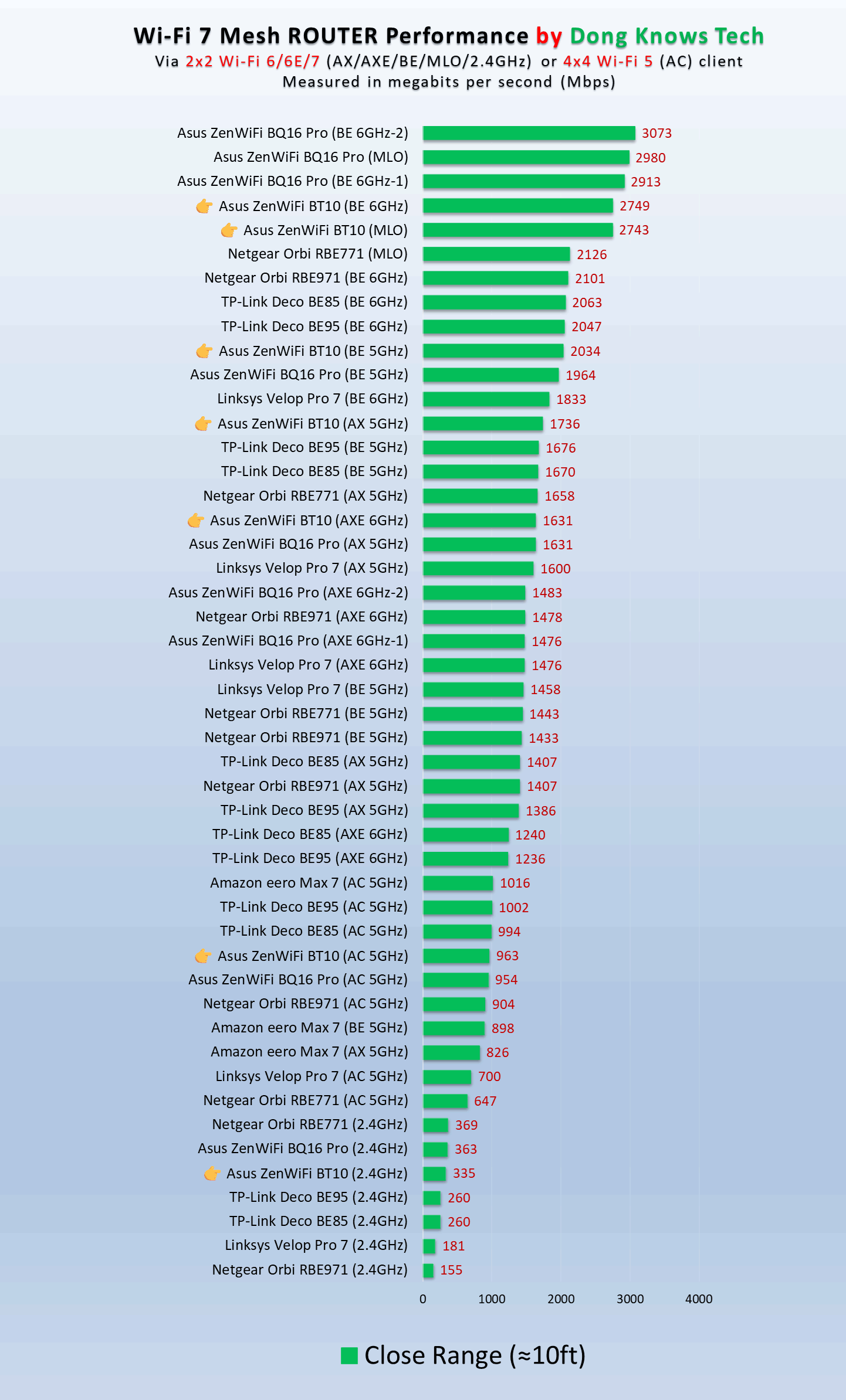

6Ghz on the BT10 has extremely limited use until AFC is implemented by Asus in early 2025. See: https://dongknows.com/asus-zenwifi-bt10-review/
Yes, but even without AFC in BT10, while AFC is already present in BQ16 Pro - the range/throughputs are roughly the same in the comparison datasets, for AX and AXE clients - same review as you linked to.
Maybe AFC in BQ16 Pro doesn't really matter in the real world ?

My (possibly limited and wrong?) understanding of AFC is that WITHOUT the device is limited to 1 watt (30 dBm). WITH AFC the device is allowed 4 watts (36 dBm). 5Ghz generally uses 4 watts (36 dBm). My experience with the two bands is consistent with these power levels, i.e. 6Ghz is very poor without AFC.
