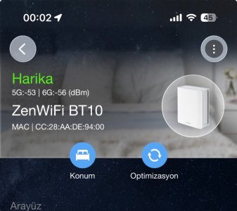

I didnt know that. Disconnected wired backhaul to see dbm between nodes. Here's the result.

They are a bit close to each other, but if it works well for you - don't worry about it. AiMesh doesn't have network tuning options and I guess your wired backhaul is to fixed locations so it is what it is.
