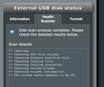

I've been having some weird problems with my DM interface , most of the times it looks like the below screenshot , but other times it looks & works as normal. I can't figure out what might be causing this behaviour. I have wiped both the router and the hdd and re-installed both the firmware for the router and the DM (also cleared the cookies and tried using different browsers) . I saw that the recommendation is to use Transmission through Entware , but I have no clue how to follow those installation steps. Maybe someone can give me some tips on how to downgrade the DM somehow or any other tips would be welcome.

Have you checked the hard drive for errors? What type of hard drive is it? What is it's format? NTFS, FAT32, EXT4, other? How is the hard drive connected to the router? Using the USB 3.0 port or the USB 2.0 port? Are you running any add-on scripts? If so which one's

Yep checked it for errors , even formatted it 2x times . It's a 1TB SSD WD , HFS formatted from the router app , hard drive is connected via a usb3 cable . No scripts , i have no clue how to use those. Thanks for the info, will try to go with Transmission if i don't manage to debug this issue.
Why is it formatted for HFS and not NTFS or better Ext4?
There are some suggestions on how to properly format a USB hard drive for use with Asus-Merlin at this link:
https://www.snbforums.com/threads/amtm-step-by-step-install-guide-l-ld.56237/#post-483421
For example from that link (assumes SSH and JFFS is enabled on the router):
Prepare the USB Drive for the swap file, Entware, and scripts.
  • If your USB drive is used, make sure to save all files off of it first
  • Format it in your computer with the NTFS file format
  • Insert the USB drive into a router USB port
  • Use your PuTTY skills above to SSH into the router
  • Type '/jffs/scripts/amtm' without the quotes and hit Enter
  • Using amtm's 'fd' command, format the USB drive to Ext4 with journaling and
  • Make sure to also Label the drive too. The router will reboot.
    • Note: MIPS routers are limited to ext2 and ext3
  • Create a swap file using amtm's 'sw' command. I recommend the 2GB size
    • Be patient while this file is created. It will be worth it
  • Using amtm's 'dc' command, enable the disk checker utility
  • Reboot the router and make sure to check the disk checker log to ensure the USB drive 'passes'
The router is now able to take advantage of the USB drive and the swap file we created on it to better manage the physical RAM it has and to always use as much as possible for the task(s) it is currently focused on.
I've experimented with Download Master on several Asus routers (RT-AC68U and a RT-AX86U Pro) and found it very difficult and problematic to use. Sometimes it would just fail outright to work properly despite testing it on several different USB hard drives. Based on numerous comments here its better to to go the Transmission/Entware route if you want to do file downloading/uploading via the Asus router.

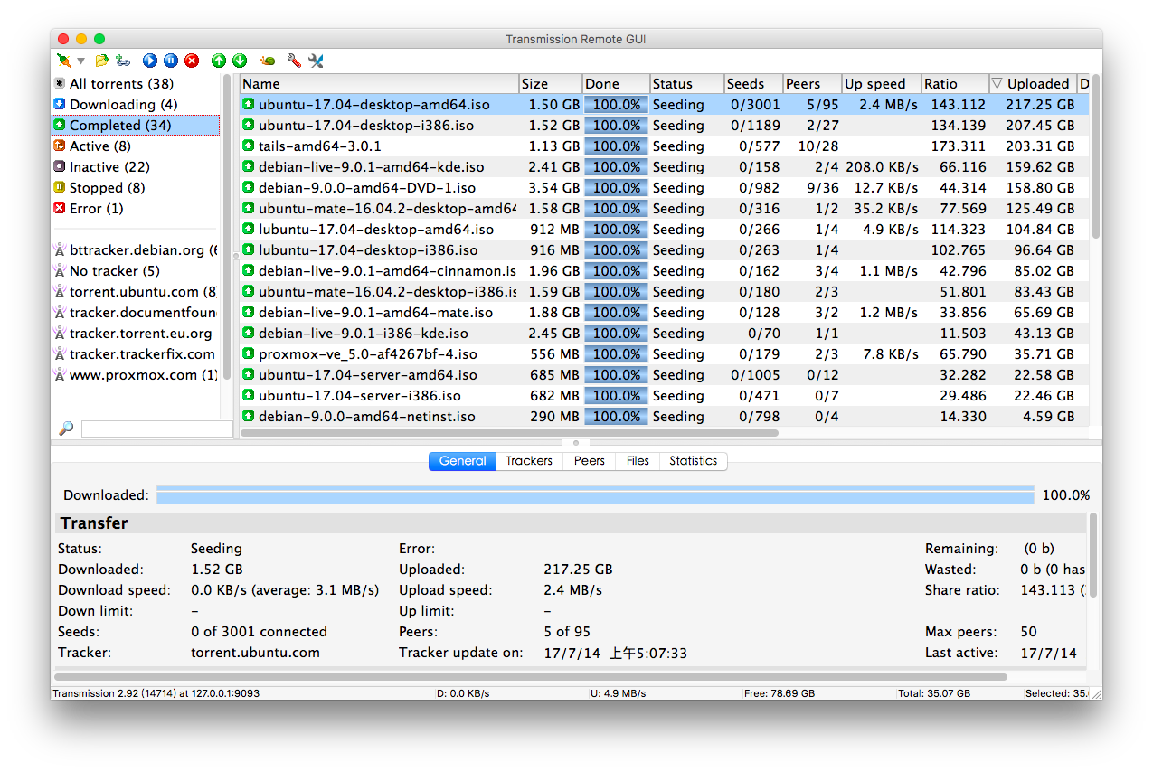

There is no ui on the router page per se. Login with your webbrowser on port 9091 (assuming you haven't changed it)
Install this too, if you prefer to using a browser - I do. There's also an android version if you have an android phone.
