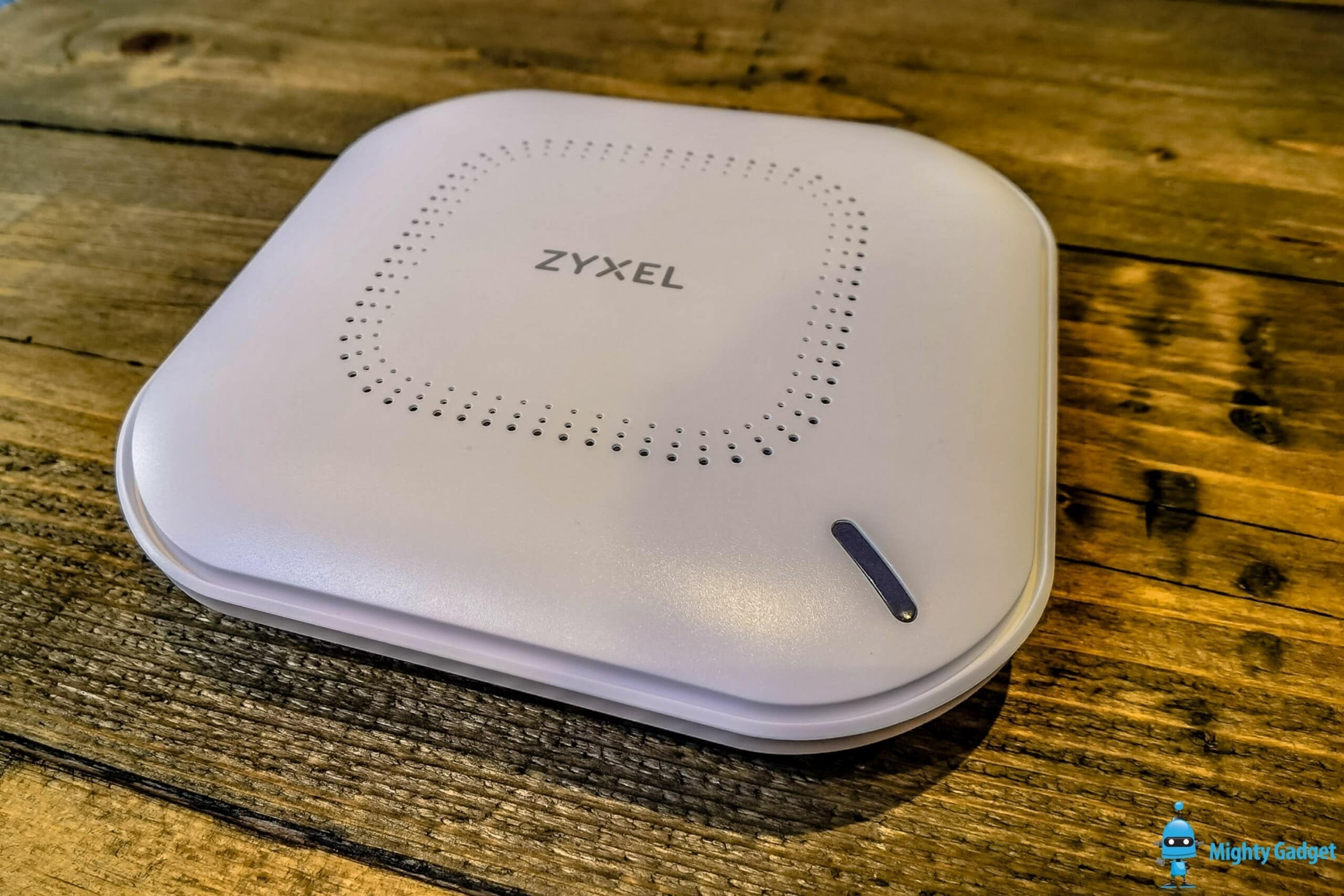

Why not use APs instead of routers? Better distance with stronger radios and it doesn't cost as much in some cases. I know everyone around here loves Asus for simplicity but your wasting time and money on how that isn't even being used for it's intended purposes.

Assume AP's require an ethernet input, something I can't run here.
Most should have a repeater mode while mine in particular allows for either 2.4 or 5ghz repeater and then full AP mode on the other it may differ with different vendors / models. Obviously if you want speed you pick the repeater on 5ghz if distance permits btu, then your AP mode side is restricted to ~300mbps on an AX setup using the 2.4ghz for clients. If you need distance then you reverse them. Since I only have a single AP I can't really do a proof of concept to demonstrate this but, the radios should perform better than a "router" converted to an AP / aiMESH.
Generally an AP will have more resources as well permitting better stability and performance when it comes to the connection as well. My uptime usually hits 90 days before a new FW release comes out which requires a reboot. When I avoided them though IIRC the uptime would hit 6 months before I would initiate a reboot or upgrade.
