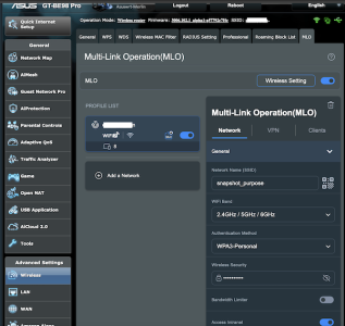

can u just share the screenshot of your MLO setting if possible.
Only enabling MLO is sufficient or enabling and add one MLO profile also needed ?
MLO setup
No need to touch that for testing purpose first. Should work as is.

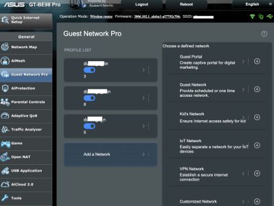

Snapshot of network pro tab
