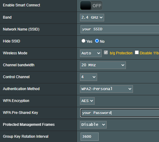

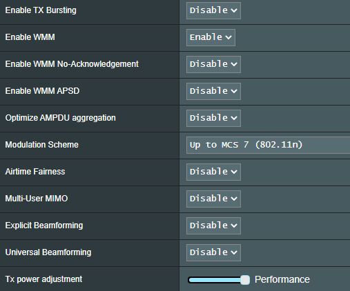

I'm testing one new IoT device as we speak with the following fail-safe settings on the same AC86U router running Asuswrt 386_48260:
The channel - whatever works best in your Wi-Fi environment. Not necessarily 1-6-11. Do not click on Disable 11b button.
Is that specific to that router? I've been disabling B for over a decade and G for years now. If nothing else, to disable the ability for a modern client to connect at legacy data rates when it is nearly out of range. On my AC1900 it doesn't have that checkbox but I have it set to "N only" which is the same thing, no issues for several years.
I suppose "Auto" effectively does the same thing if it doesn't see any B or G devices, but I'd rather have it locked in.
I guess on an IOT specific router, leaving data rates as low as 1M enabled might be beneficial for outdoor lightbulbs or other stuff that is very weak signal, but I wouldn't want it on my main AP.
Asuswrt specific. On some models/firmware you can't remove it and it creates connectivity issues.
