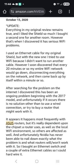

This is true. I run Bitdefender Antivirus on our boxes from time to time to keep things clean. I discovered last week that even the Nvidia Shield Pro has an ongoing networking issue if running it via Wifi. The Amazon reviewer of the Nvidia described it fairly well in the attached screenshot.
Do you have any advice on how to go about confirming whether or not my boxes might be running their own DHCP/DNS server? Rogue or not?
