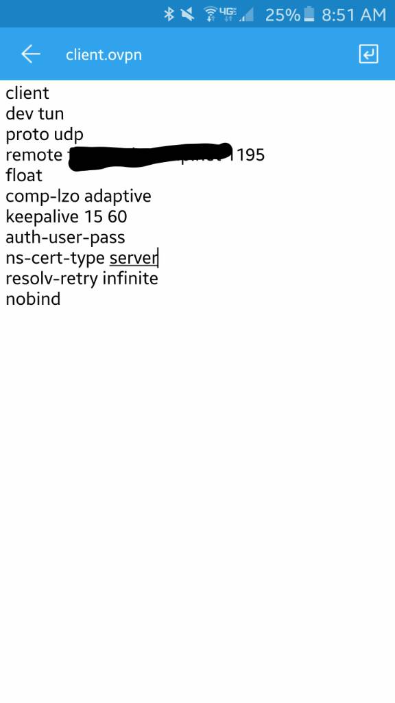

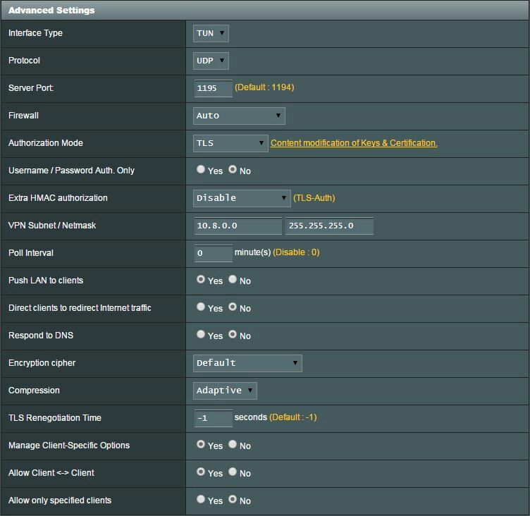

So I setup the OpenVPN server on the router the other day and was immediately able to connect no issues. It seems I can even use the SFTP/SSH settings on my phone to connect "locally" without any changes.
But it's hung up on samba. No amount of discovery or manual addresses can find them.
The samba server is on a Debian Jessie box hard wired to the Asus Router.
Upon a bit of googling I saw advice to setup samba as a WINS server, and I've put the known address of the box in Windows 7 to no avail. But then I started wondering if it had to be the VPN ip or standard local ip?
Any help is greatly appreciated, seems to be a lack of documentation when it comes to the server side of vpn on these routers.
Server configure page and client config below
Sent from my SM-G920V using Tapatalk
Samba over openvpn has a number of documented problems. The root issue is that when you use the tun interface, your openvpn configuration has to advertise all routes to other devices. There are generally two ways to get SMB over openvpn working.
If you want to use the tun interface then the first way is to configure a WINS server that resolves requests for netbios names and push the ip-address of the WINS server to clients so that they can use the WINS server to find the SMB server. Some additional configuration may be required.
The easier way (in my opinion) is to use a tap interface instead of a tun interface. This basically has openvpn act as a layer 2 bridge that merges the client into the home network at the link layer. Once you have a working setup using the tap interface, SMB will work without any additional configuration. There are some documented performance issues when using the tap interface at scale, but on SOHO networks, the performance is equivalent.
Thanks for the reply :)
Yeah I had read that TUN will provide better performance but there seems to be some disagreement on the internet over that topic.
I've followed a simple guide to get WINS via the Samba daemon on the debian box, but tbh I have no idea if its working (I suppose not as I can't connect to those shares remotely haha).
I'm wondering if I need to adjust known hosts or whatever on the debian box. Thats really the only computer I'm looking to access remotely.
At this rate I'll likely give TAP a try as it's easy enough to reconfigure the router's settings. Just a little challenge to get TUN working (and apparently networking challenges are my thing now).
