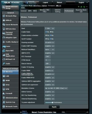

/////* EDIT:*/////
After much tinkering with the router's WIFI settings I've been able to once again hit download/upload speeds equal and beyond the ISP advertised speeds. The difference is indeed meaningful across all WIFI devices. I've been testing this for the past couple of days and the difference is indeed among the following 2 settings. With them Enabled all is well. With them disable, the issue comes back.
The settings are found under Wireless/Professional
Optimize AMPDU aggregation: Enable
Optimize ack suppression: Enable
I've attached a picture of the overall settings.
I hope this is of help to anyone experiencing the same issues.
/////* END EDIT:*/////
