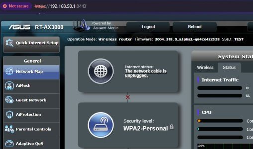

I sort of wished I hadn't asked :) ...but for the first time ever, I had to use rescue mode to upload this firmware,

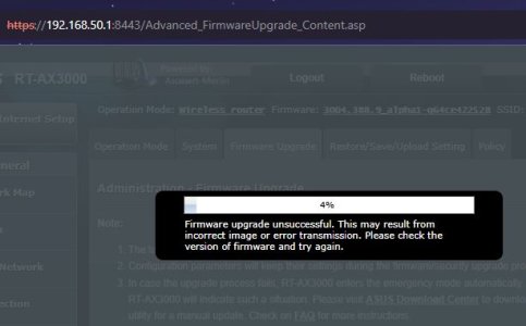

I don't know if this was due to updating from Merlin's 3004.388.9_alpha1 (maybe it was just jealous?) or my system, or just the phase of the moon, but I tried from the Primary Router's FW admin page to update the firmware for the AIMesh Node, first Wirelessly, then connected via Ethernet and both times ended up being "in search of incredible... frustration". "Unsuccessful", yeah thanks ... story of my life.

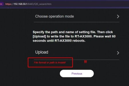

Anyway so after those first two trials (Wireless and Ethernet), I thought OK I will hard reset it and I know there is advanced menu when you go in using the asusrouter.com address in your browser, so you don't need to go through any wireless or admin login/pwd setups.
Well, that didn't work either.... the error this time was "File format or path invalid". It hates me. Meh, fat chance, boyo.
