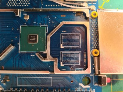

Hello, I have bought the ASUS RT-AX88U, but the Pro version (RT-AX88U Pro), which has 1 GB RAM, but from what I have read it is DDR4.
I would like to upgrade it to 2Gb, is it possible? Which memory should I buy?

Thanks, any suggestions on how to find the memory model? Or do I have to disassemble my router to see?
memory k4a4g165wf-bctd
Thank you very much! I have found this memory:
https://www.datasheets.com/en/part-details/k4a4g165wf-bctd-samsung-electronics-409067952#overview
Which is made by Samsung will this do fine? It is 4Gb
Be sure the RAM capacity is within the limits of the SoC you're trying to attach it to. I believe 4GB is beyond that limit.
The router has 2 k4a4g165wf-bctd chips, 512 MB each (256M x 16). To increase it, you probably need 512M x 16 or 1G x 16 or 2G x 16. Theoretically, 8GB can be supplied. I looked at the sources. It’s not immediately clear what code is responsible for the memory configuration. The configuration is different from DDR3 memory. The configuration file is asuswrt-merlin.ng/release/src-rt-5.04axhnd.675x/shared/opensource/boardparms/bcm963xx/boardparms_4912.c. There is a similar router gt_axe16000_2gb with 2 GB of RAM. You can understand it with an example.
Thanks very much, I will try my best regarding de SoC which is Broadcom BCM4912 I couldn't find the RAM capacity limits.

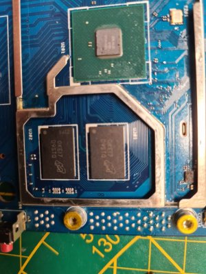

Hi Chavo, thank you so much for your detailed instructions.
I've managed to order the parts you linked from aliexpress and succusfully patched the firmwre to allow for the memory to be used.
All went smoothly. Many thanks, this gives me much more headroom as I was running out of memory before.
Just out of curiosity, how did you find out how to patch the firmware.
Did you search for specific values in the binaries? Any special software you advise.
Thanks again!
Thanks again!
in short: 1) found the code responsible for the memory configuration in their codes 2) compiled it before and after changing the configuration 3) compared the files binary
