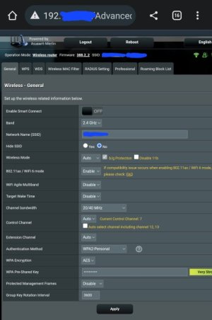

Here are my settings
Any help what I can do??!

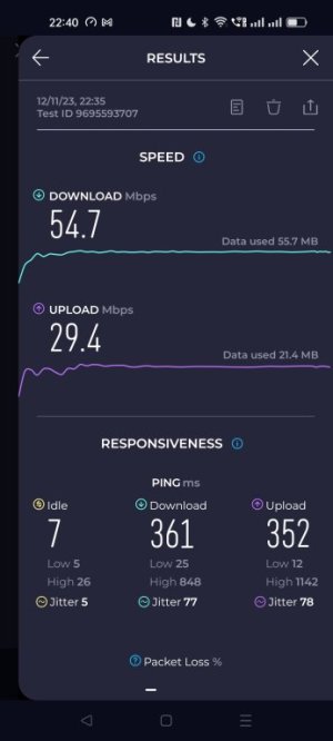

What distance from the router are you testing at? 5 meters from my router I'm getting 54 Mbit/s

I only have 5 esp devices on the guest network so not really as loaded as you probably are. Even 802.11n wifi should deliver a 54Mbps connection, and does in my case.
