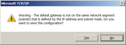

Maybe I'm misunderstanding what you're saying. You seem to be saying that the client's network interface should have a subnet mask of 255.255.255.252 even though the local subnet is /24. That's just wrong.

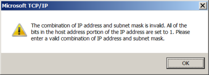

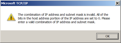

You are confusing IP address ranges with subnets. If the local subnet is /24 (which it is) then that's what needs to be set on the client's network interface. A subnet of 192.168.50.20/30 gives two host address (192.168.50.21 and 192.168.50.22), with 192.168.50.20 being the network address and 192.168.50.23 being the broadcast address.
View attachment 47206View attachment 47207View attachment 47208
You're absolutely correct... I forgot that the first and last were not usable. So the next viable range to give him at least 4 usable IPs would be:
192.168.50.16/29
giving a usable range of:
192.168.50.17 - 192.168.50.22

You can still use CIDR notation for the VPN routing. My point was that you shouldn't change the subnet mask on the client's network interface. That's not a valid configuration.
