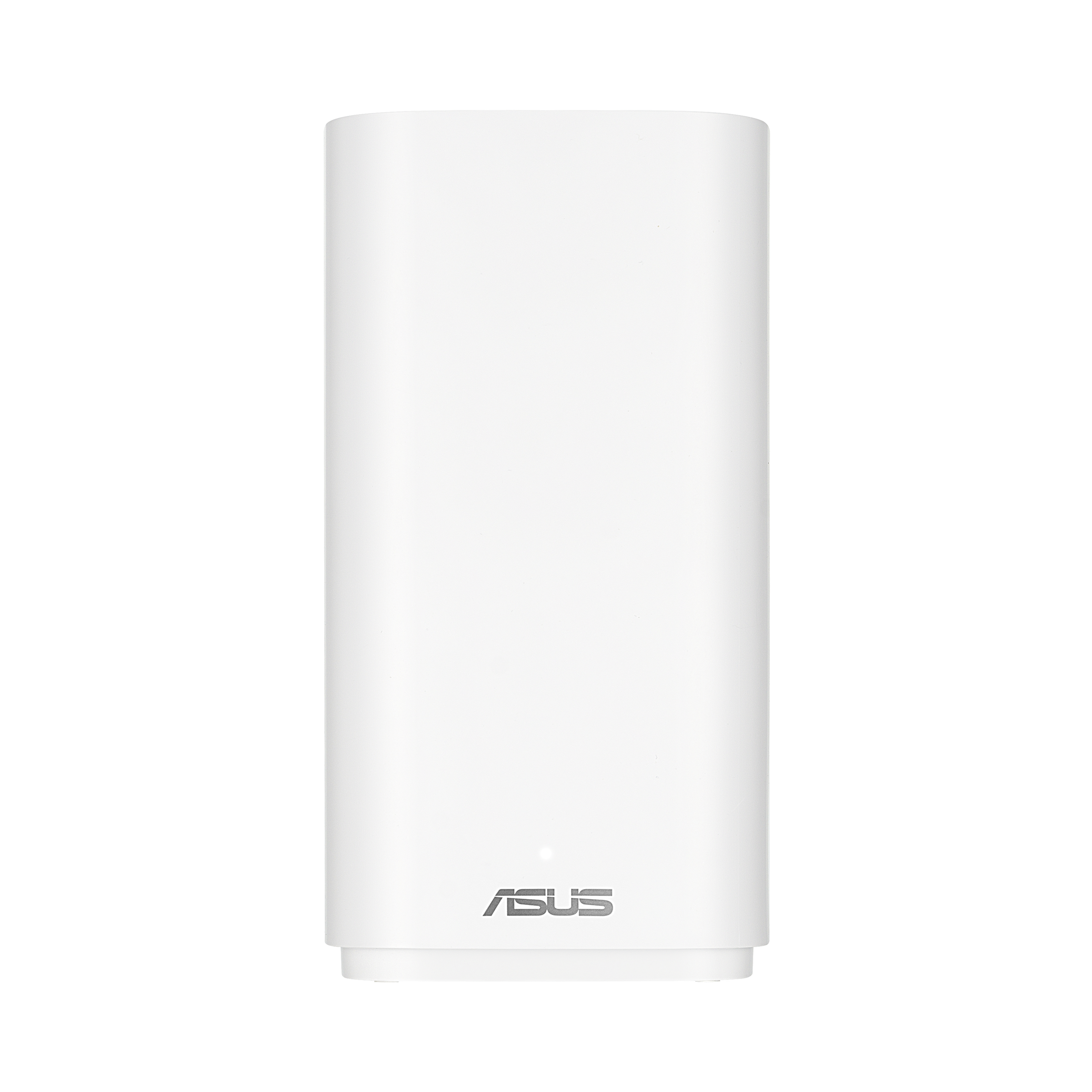

ASUS ZenWiFi BD5 Outdoor Transmission Power
Ahhh... thanks all!
I think I found it. The FCC Certification Number is MSQ-RTBE8300 for ASUS ZenWiFi BD5 Outdoor. Previously, I was only finding the BD5 (indoor).
From Page #50 of the Radio Test Report found at https://device.report/fccid/msq-rtbe8300,
looks like the unit is capable of 30dBm Transmit Power:
