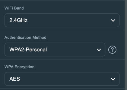

Ah yes. I only have wpa2-personal set since I only run IoT devices on 2.4Ghz. I don't even have a 2.4Ghz SSID assigned for my main network. The second item is interesting. Are your nodes also ET12's?
I see your point.
My IoT SSID is 2.4GHz only. But my main SSID is set to Triband Smart Connect.
And I only have a pair of ET12s...both running latest firmware.
My issue must be something to do with the firmware because:
1) I can get IoT to connect to the main router, but not with the node.
2) I swapped main router and the node ... as in trying both ET12 units as the main routers...and the issue persists.
So overall I feel that the firmware isn't setting up the AiNode properly to serve WPA2/WPA3 Personal security to the IoT devices.

Interesting. Have you tried removing 2.4Ghz from Smart connect? When it's outside of smart connect you may see different encryption options. I have them all separate but same SSID and password for 6ghz and 5ghz. When you swapped the router/node, did you start from scratch or restore the config? Is the 2.4Ghz radio enabled on the node? Also have you tried breaking the mesh and re-adding the node again?
My IoT network is 2.4Ghz only...which is where my problems area. And it's enabled on all mesh nodes.
My main network is Triband and it has no problems.
For all my swapping and different ideas... I setup from scratch. I don't restore settings at all.
I'm able to replicate the problem by changing IoT SSID security between WPA/WPA2 Personal (works) and WPA2/WPA3 Personal (doesn't work).
Seems to be something to do with WPA2/WPA3 Personal security setting.
Quite a few have reported compatibility issues to the various Asus subforums on this site when using WPA2/WPA3, or just WPA3, when it comes to WiFi clients on the 3006.x firmware. Seems quite a few have problems with the WPA2/WPA3 on the Guest Network Pro feature when using certain IoT devices. The workaround, for most seems to be drop the WiFi authentication down to WPA2-Personal or WPA/WPA2. Some also have to change a few of the WiFi 2.4Ghz settings as well. Like setting the frequency to 20hz and setting the channel to 1, 6 or 11.
