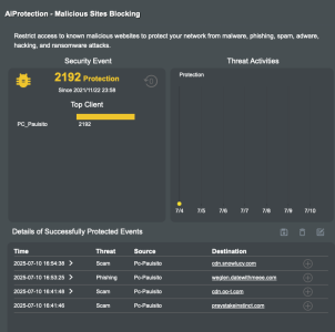

I use AirProtection: malicius site blocking and infected detection on (I see a lot of protections logs from my son's PC).
Given all the hits on your son's browsing, i would make sure he is running as a regular user, not admin user. Install Malwarebytes or similar and at least MS Defender or other intelligent AV if you are not already using something like that in addition to AiP. Not sure why AiP would be causing the issue, but i have never used it. There are likely browser plug-ins if not handled by AV/AM.

My son uses MS Defender, but seams that isn't enough. Do you have experience with malwarebytes? Maybe, I will buy a license and try to clean all the malware or virus.
I don't use AiCloud.
I've only had good experience with malwarebytes over the years. Never found anything, but i don't freely click. Kaspersky was pretty good, it found a few things. Norton was pretty invasive but solid. Used it for macs and win. Defender + Malwarebytes and careful browsing should be reasonable. If you can put your son on his own VLAN, that would help isolate him from other users. i wouldn't toss out AiP. It will only add latency if he is a gamer, but will give you another layer of detection/defense.
Indeed! These days I would put kids/others on their own network including a dedicated printer (dedicated hardware is cheap protection, imo)... and keep as many as possible off the main network.
OE
I installed malwarebytes and it founded and blocked malware. The software puts the malware in quarantine, I delete it, but after reboot, the malware appears again, but blocked by malwarebytes.
No reboots, but AirProtection is still disabled.
That suggests a deeper issue in the PC. i would query Malwarebytes on how to remove that malware.
