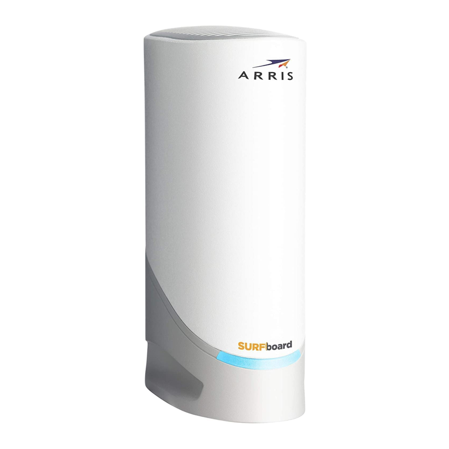

After racking my brain for the past few weeks as to WHY my speed dropped from 800-900 to 500-600. I even went out and got a new Modem (Arris S33). I found out that my AX-86U (on Merlin 388.1), had IPV6 enabled. I turned it off and it's working correctly. (Getting 1000-1200Mbps from spdMerlin at the router).

Well, now I have a new Modem..that will keep me good up to 2.5G service on Docsis 3.1
