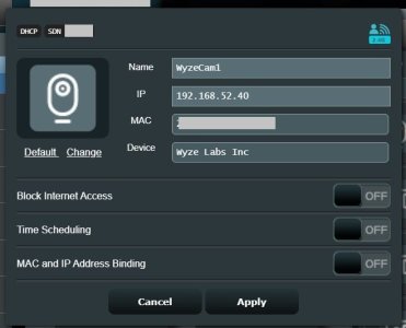

Custom client names in network map aren’t used in answering dns queries from conditional forwarding.

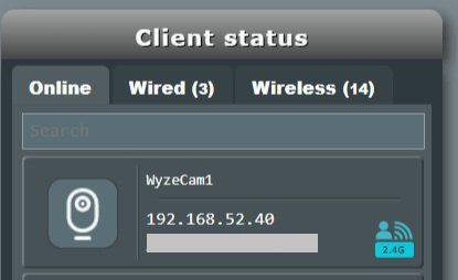

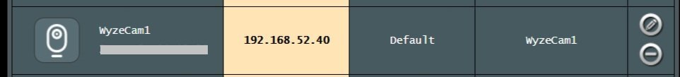

To add to this, if one uses manual reservations (LAN > DHCP Server > Manual Assignment) and sets a Hostname for the client. Pi-Hole's conditional forwarding should pickup that Hostname value when reporting the queries. It is possible that using YazDHCP may also help with device naming in this instance. Some examples attached.
Network Map client dialog:
Client Status:
Manual reservation using YazDHCP:
Client Status:
Pi-Hole Query entry.
