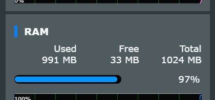

I'm trying to figure out why file transfers to the USB attached storage (yes, i know i should be using NAS instead) has dramatically slowed down to 10MB/sec on my gigabit network. Normally, when I reboot the router it starts off with several hundred MB of free memory, which then drops to 30 MB or so if and when I start accessing the USb storage. That is expected. It should be using any available RAM to cache the storage.
But now when I reboot the router, it starts off w/only 30MB free RAM. FRom the boot log, I see:

Well that was from the boot log. As soon as router is up, i see:

While your title says "not USB storage", having the RAM spike to 97% is very common when the USB device is being used (read/write) often. There are a number of past discussions that are similar, extremely high RAM usage when people use USB storage devices on the router.
One troubleshooting step to try is to delete the router's cache and see if that drops the RAM usage down to normal levels (for your use case). However, clearing the router cache is a temporary solution since the RAM usage typically shoots back up to above 90% after a period of time due to USB drive usage. One can try one of the following three SSH command line entries (SSH into the router and issue one of the commands) to see if they can lower their router's used RAM.

Your router's hardware is the speed limiting factor, not the USB port. What you see for RAM usage is normal when USB storage device is used. I personally haven't seen AiProtection taking 300MB RAM on any ASUS router.

Yes, when I'm using the attached USB drive I expect RAM usage to fill up (like it does) for drive caching. I'll try those commands although I only telnet into router for some reason I don't remember.
OK, now I see AI protection is 75MB or so. But yesterday when I was testing and finding it taking 300MB, it was also spamming my DNS log with this so poerhaps updating?
