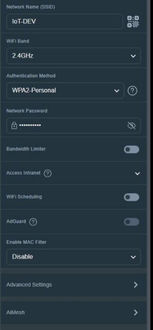

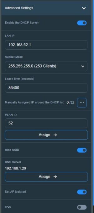

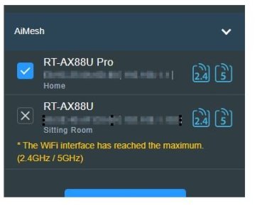

3006.102.7 is the firmware on the Pro.
I had guest profiles before but they were on the same subnet , they seemed to work fine

confirmed that they are not set to static IP and mac filtering is not enabled. The fact that it won't broadcast when I unhide the network is puzzling.
Factory reset, reconfigure manually and do not hide the guest WIFI SSID! Also use a different subnet than the LAN subnet.
