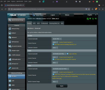

It's running on my RT-BE92U.

Yes.
I also have a laptop that connected to it in the 6GHz band.
Although in the end I switched it off for client connexions and reserved it for the AIMesh backhaul, as I have an older node (RT-AC86U) which doesn't run 6GHz and it seemed to cause problems when a client using 6GHz switched to it.
I don't really need it for clients.

What bugs me is that 6 GHz shows "20/40/80/160/320 MHz". The 6 GHz radio is 2x2 and supports a maximum 5764 Mbps, which is up to 160 MHz only. Why is 320 even there?....
