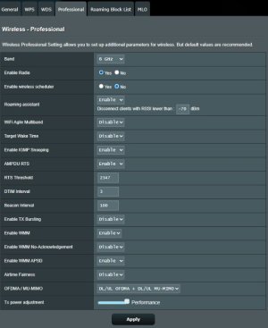

the issue that i am seeing right now is wifi 7 speed on 6ghz is slower than wifi 6 on 5ghz.
I have 1Gbps download, able to achieve ~700 Mbps on 5ghz with Iphone 14.
But on 6Ghz using Iphone 16, it can only achieve 200-300 Mbps max.
how can i improve wifi 7 output ?

Did you change DTIM to 3, this is what Apple recommends. See post #19
Use Apple's "forget this network", then reload and see if the speeds improve.
hi John, thanks for your suggestion.
Change DTIM to 3 and still no speed improvement.
Did you reset the network on the phone, you only answered half of what I suggested?
Also, change DTIM for the other 2 bands, not just the 6.
Provide screen shots of the 3 bands for the Professional Tab so all can see where you are currently.
EDIT: try turning on WiFi Agile Multiband on the 6 band, under Professional Tab.

The actual DTIM interval is DTIM interval x beacon interval, measured in TUs. Changing this has no impact on performance; simply leave it as is.
Wi-Fi Agile Multiband is actually MBO, which also has no impact on performance. ASUS doesn't provide any parameters for MBO, so enabling or disabling it has no real effect.
If you need to diagnose speed issues, observe the device's RSSI and the deviation between the negotiated link rate and the actual speed, rather than fiddling with any wireless settings first. ASUS's WebUI allows you to view each device's realtime RSSI and negotiated link rate.

What's the speed of the iPhone 16 when connected only to 5GHz? Comparing across devices is meaningless, as iPhone 16 and iPhone 14 are equipped with completely different WiFi/BT modules and drivers.

In fact, the only use case for the DTIM interval is to maintain a constant actual DTIM interval when you lower the beacon interval to reduce passive scan latency, so that your STAs don't exit low-power too frequently when idle due to a low beacon interval, rather than to address any throughput issues.
The only purpose of MBO is to help ASUS pass WFA certification, as it is a mandatory feature for WiFi 6 certification. For end users, MBO without parameters is meaningless. If you know this, you can disable it to save some bytes in the beacon IE.
