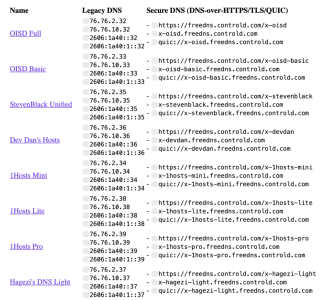

The following 3rd party blocklists are currently supported on ControlD
