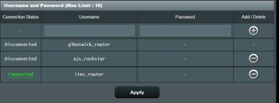

Thanks again @eibgard. TBH I am amazed at your ability to switch between multiple threads at the same time and still maintain continuity of the context. And I am also extremely grateful for that.
Just to confirm - based on your previous advice I did not opt for the username-as-common-name approach and stayed with the individual certificates. For the client router I generated a certificate and key with a common name of cn_itnc by following the instructions in the post by @jsshapiro.
Now here are the user names configured on the server
And here is the list of Allowed Clients:
