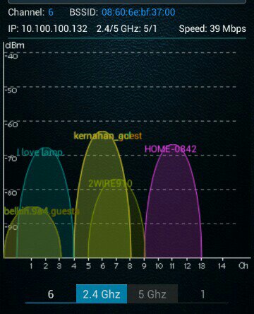

At least part of the answer is here:
http://www.smallnetbuilder.com/wireless/wireless-features/31743-bye-bye-40-mhz-mode-in-24-ghz-part-1
Since the AC66U is listed as one of the few that implements a spectrum check, I think the behavior some of us are seeing is a full implementation of being "neighborly".
I am channel 6 in this scan. Here's what I think is going on: When the AC66U sees this environment, it will not allow 40mhz mode. I think it may also be restricting 802.11N to "legacy" mode to further limit bandwidth and reduce interference.
Not allowing 40mhz in this case makes sense under the new spec.
I don't think limiting N to 54mbs as well is required. N uses multi path and selective cancelation to create multiple information channels on the same frequency. This is the reason for three or more antennas.
Because it is designed to separate multiple information channels on the same frequency, a major feature of N is high tolerance to interface. Restricting the AC66U to 54mbs just hurts it's performance without much reduction to interference.
As it was in .270, please consider allowing Auto and N only modes independent of the detection of signals on nearby channels.
Thanks.
