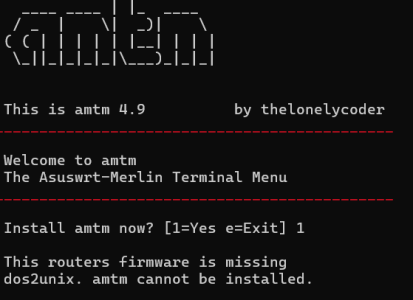

I'm trying to install amtm on my RT-AX86U Pro. I'm following the instruction on https://diversion.ch/amtm.html
Getting an error after first step:
"This routers firmware is missing dos2unix. amtm cannot be installed."
Am i doing something wrong? Is it possible to install amtm on my router?
Thanks.

You shouldn't need to install it. Just connect via SSH and type amtm.
You are actually running Merlin firmware? (sorry, had to ask!)
getting this:
admin@RT-AX86U_Pro-5F38:/tmp/home/root# amtm
-sh: amtm: not found
Actually i dont know. How to check it? I'm new to this
Access the router GUI, if running Asus-Merlin it will indicate such in the upper left.
