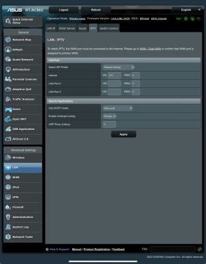

I understand that I can configure this setting on the RT-AC86U by going to LAN > IPTV, then Change Select ISP Profile to Manual Setting, then type 101 in the VID field but what do I put in the PRIO field? Also do I need to do anything else?

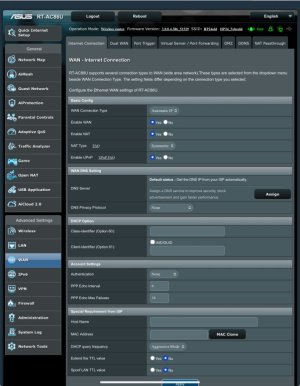

Took 2 minutes for me to connect my Asus router to the ONT, I simply plugged my Ethernet cable from the ONT into the internet socket on my Asus router then logged into the Asus admin went to LAN>IPTV and clicked on the dropdown for Select ISP Profile and selected Manual Setting, put 101 in Internet VID, then went to WAN then changed connection type to Automatic IP. Rebooted the router and it connected.
No need for the Connect Fibre router to be connected at all just the ONT and the ASUs Router.
