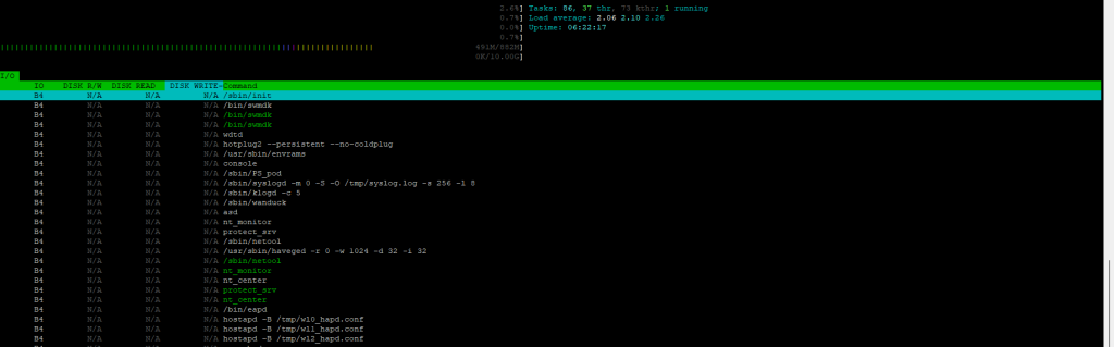

Tools like htop (under IO tab/disk read or disk write) or iotop or iostat can help see what activity and command is being issued.

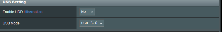

Alternatively disabling HDD hybernation will disable the spin up spin down and leave it always spinning. But again sound.

iostat works also to see that exact disk.

(above pictures are from other devices not necessarily the router)

I've never noticed the I/O tab in htop! 😅
Already had it installed on the router, exactly for troubleshooting purposes ☺️
