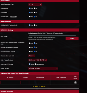

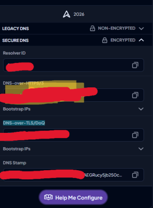

Hello there

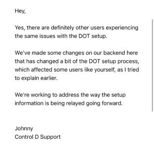

i have rest my router rebulid the Endpoints by controld ihave still problem with get DNS-over-TLS Server working DNS-over-TLS/DoQ i have mailed controld d a few times they dont give me any fix
any one can helping me

Controld DNS working just fine here with the Asus presets. DoT works fine as well. Possible your ISP is blocking DoT? If so you can use Controld with DNSSEC.
Well, once again I'll have to eat crow. I was using ControlD with DNSSEC and switched to using DoT and it did not work. Stay tuned as it could be operator error...
thanks alot normal my ISP dont blocked anythink it worked fine for last 2 years only 3 days ago the problem start even with Controld with DNSSEC not working
I did a couple more tests with ControlD. Their website has changed or is having problems as some of the settings for their various services do not come up. ControlD conventional DNS is working for me even with DNSSEC enabled. Bur their DoT is not working. Other providers in the same data center (IAD) are working with DoT and DoH.
For now I've gone back to using a Pi-Hole connecting to Cloudflare Security over DoH.
