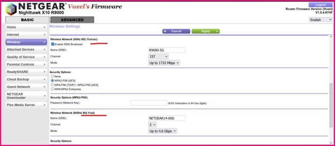

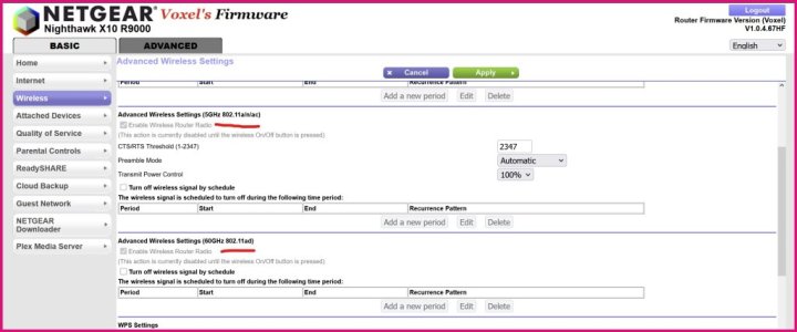

With the external Wi-Fi on/off switch is in the off state, I note the option to enable/disable the 802.11ad is greyed out as expected. However, when the external Wi-Fi on/off switch is in the on state, the option line is completely gone. In other words, when the external on/off switch is on the 802.11ad radio is on full time. No option to remove the enable check mark like for the 2.4 GHz and 5 GHz radios. See attached images.
Is this correct?
I never use the physical button to switch the Wi-Fi. As @Panner correctly noted, it is better to use advanced Wireles settings page
Voxel.
Thank you both. I have learned something. I am now using the Advanced Setup Wireless Settings page to disable the wireless radios.
I used the manual on/off switch because it was convenient, but it did control all three radios.
