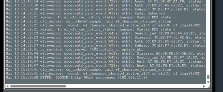

anything i do about this.. i have a bostrend ac1200 ap only being use to connect a apc nas network card to my network.. not being used as a true ap.
everytime it looses connection when the main wifi router it connects to changes the channel because of radar dfs i believe.

i am using hard coded channel 36 on the single 5ghz band enabled on this router.. i would have thought from ai that dfs would not be an issue here?

i th9ough i am already doing all that see attachment

is the only way to avoaid this to turn off 160mhz from reading i though channel 36 which i hard coded is dfs free. but maybe the extension channel is causing the issue
