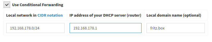

PiHole has two ways of solving this issue.
  • It can replace router DHCP server - that way is fully aware of any host in the network and its IP address. I don't recommend this, you are starting to distribute the network management between multiple devices. You'd need to manually keep the configuration in sync etc.
  • PiHole can perform conditional forwarding: it can ask the main router running DHCP to resolve names in the local domain. Below an example for a fritz.box local domain (DHCP running on a Fritz!Box router). Reverse resolution (from IP to FQN) works as well.

Yep. This is expected. PiHole doesn't know anything about your local devices and cannot resolve their names. You need to enable Conditional Forwarding. It is not extensively described in PiHole documentation, but have a look here: https://docs.pi-hole.net/routers/fr...pi-holes-web-interface-conditional-forwarding
  • Local network in CIDR notation should define your local network, typically 192.168.0.0/24
  • IP Address of your DHCP server - typically 192.168.0.1
  • Local domain - name of the domain specified in the LAN/DHCP Server page. I think the default is local.
That way, if PiHole receives a request to resolve FQN in local domain, exp. myDesktop.local, it will try to resolve it locally. It knows nothing about it, so it will go to your ASUS to ask for it, not the upstream server (AdGuard). This still enables you to define static IP address allocation through Asus UI and PiHole resolve them properly too.
What's more, the PiHole dashboard will be very nicely populated with hostnames - you'll easily know which host is querying etc.
