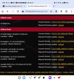

Something was wrong when OFDMA/802.11ax MU-MIMO was enabled on the ASUS 6E routers (both AXE16000 and AXE11000 that I have owned purchased new) when attempting to connect Apple's first 6E MacBook, as well as Metal Quest 3 in one case someone complained about not being able to connect to 6 GHz (I believe that was an AXE7800). Not sure I'd advise wasting time on a new one as tester. Try to find and test the beta 9.0.0.6.102_4856 before you throw in the towel/if you're curious. I'm afraid it may not be safe to keep as main router firmware, but at least for Ethernet seems like it's running well. I have not made a determination on its WiFi performance....

I see nothing on this screenshot. Blurry image of some text with red lines in between, Gear Acquisition Syndrome at the bottom. 🤭
I believe microwave ovens are cheaper and make popcorn faster.
Is this first tab in your screenshot about "How many people have died from Wi-Fi radiation overexposure?" 🤔
