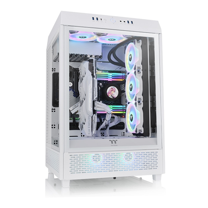

My new build case: the Thermaltake Tower 500.
I decided to use this case because the way the motherboard is mounted vertically with the rear panel pointing upwards.
I'm debating on if I want to install LED fans since I'm going to put this in a closet, but I am undecided if I want to use this case permanently for this application. But I might end up liquid cooling it considering where it going to be installed. Its hard to predict this until its built and tested thoroughly.
Installed the motherboard and new heat sink. Planning cooling around static pressure method modifying the cooling around it instead of using passive thermal velocity the cooling of the case is designed around. Because its more suited to remove waste heat inside of an enclosure rather than it is designed to cool down devices directly. But they made this for their liquid cooling system instead of passive air cooling and its not going to be good at this.
Blocking the sides on the lower intake so just the front is pulling in air with high velocity and static pressure fans was the start, then sealing any air leaks and separating and establishing cooling zones was the next step in the process. I stacked four LED fans and aluminum tape origami them into place as well as extending the tape below the cover plate on the bottom. If I need to get aggressive with sealing the sides from the bottom section, I will add some weather stripping to this mix.
My front fans are Iceberg Thermal IceGALE Xtra that I took off of a decommissioned Antminer S9. I ordered more of these so I can replace the two wimpy fans they stuck in the back. These fans along with the heat sink are plugged into the motherboard fan headers. The aLED fans, I plan to run independently, and maybe even put the fans on a thermostat so when the air outside the case is above a certain temperature, they kick in.
