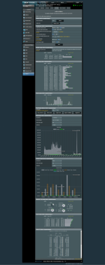

Here's my vnstat screen if that helps to sort out what's going on.

Here you go. I also just did a display of vnstat from the GUI, so that should correlate closely to the output file.
I've tracked down the cause for this, I'm currently rewriting how the "current/previous 7 day" comparison chart works as a result

It looks reasonable. See the attached screen capture.
