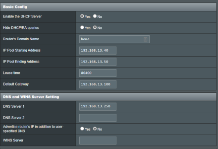

Don't advertise router's LAN IP as DNS server.

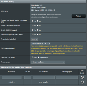

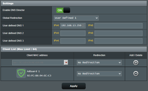

I'm not, 13.100 is the router and 13.250 is Adguard. I've attached screenshots of the relevant config, maybe I've set something wrong or missed something.
This request should have been shown to be from a different ip, not the router

The WAN DNS section is set to Adguard (their public DNS, not my container). This is or should be used only by the router itself.

This is the redirector setup to avoid loops (Shove everything into Pi except the Pi itself, which is directed towards Cloudflare DNS).
Usually, I keep my laptop's MAC with "No redirection" in here. It usually has a DHCP assigned DNS, but I want the ability to query other DNS if needed. For testing purposes, I've removed it from here.
