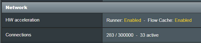

This is the number of network connections being maintained vs active.
I would like to figure out how to time these out.
@Morris I get your point but I can't make any connections outbound. DNS queries are not the connections I'm having- they just all fail. I rate limited the application for a while; however, what happened is that the Validator started getting behind. It needs to be able to connect at a high rate.
I need to figure out how to make inactive connections drop so that we don't have one kid keeping all the toys for the sake of having them.

I am just trying to figure out how in networking terms to limit impact to the network. As you can see above the router is maintaining over 4000 connections of which it believes only 708 are active. Those 4000 connections seem to be blocking my ability to make more of them.

The problem is "officially solved" at this point with VPN inside the guest virtual machine.
Without the tunnel, we were getting blocked by the number of outbound connections. Based on the number of connections out of "30,000" listed in the network status, I don't think this was the merlin router but I can't be sure.
Note that initially the VPN on the router and then inside the guest linux vm were not fast enough to keep up with this intensive application. However switching the expressvpn protocol inside the virtual machine to udp/lightway drastically improved performance to the point where it could keep up. The VPN is not being used for privacy here- it's merely a networking solution for the connection issue.
