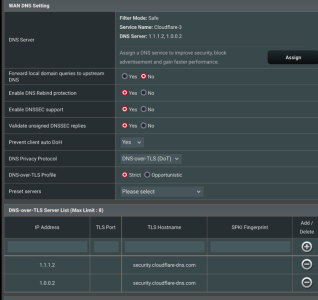

I think a factory reset and reconfigure is the way to go. Here is my config with Cloudflare that works. I don't have DNS configured anywhere else currently.
