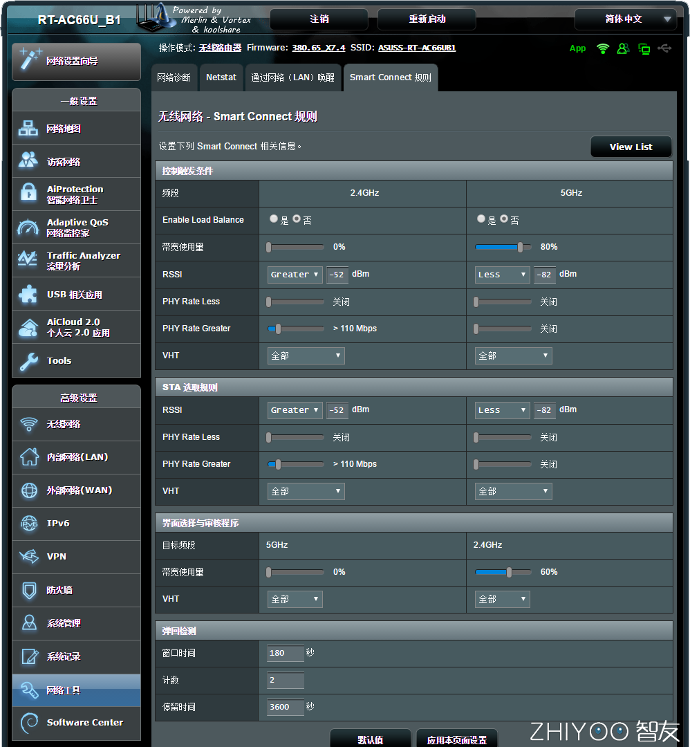

Actually,RT-AC66U B1 support Smart Connect.I can use this function in a third party firmware.
Just stock firmware cut this function.
koolshare,I don't understand why this firmware has Smart Connect but Merlin has not.
Never heard of that and I don’t understand Google’s translation of the Chinese on their website I’m afraid...
I don't understand Chinese but it's easy to try,I just tried and review github repo of this firmware.
As my router installed DD WRT today,I can only find a screenshot from other website for your reference.
I am not sure whether this firmware has copyright issue but I am really appreciate it. I just don't understand why this firmware has Smart Connect but Merlin has not.
One can conclude that Merlin chose to not include Smart Connect.
The screen shot above states, "Powered by Merlin & Vortex & Koolshare". They left out ASUS. Being Chinese, it should be no surprise that this firmware is likely a mashup of firmware code/technology by others.
