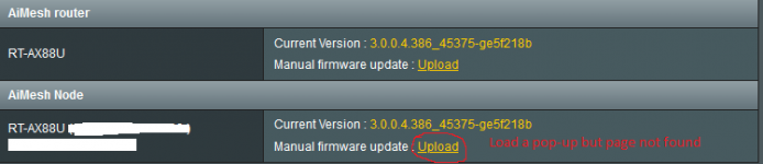

Related to this topic I would like to downgrade both of my rt-ax88u. The problem is that i can't access the gui of the node to actually upload the fw file. the webpage returns an error. In the gui it is clearly specified that both fw (on the main router and the node ) should be done separatly but i can only perfom the operation on the main router. Any ideas?
Reset the node, go through the setup wizard there, downgrade firmware, reset again, re-add as node.
Where can I reset the node?
At the node. Remove node may reset it as well, but I would press the Reset button. I like buttons.
