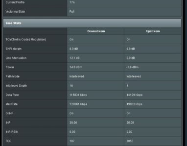

The only issue i have is i cannot get any device including the modem itself to upload over 20mb/s
Im on a 100/40 plan here in aus and am actually syncing in the DSL logs as 100/40.
Does anyone know a way (CLI over ssh) to change the speed. Im not sure why Optus removes most of the settings pages. pretty frustrating....

Did it upload faster before you hacked it? If not only your ISP can fix it, you may be provisioned incorrectly. Of course they may require you to restore the router back to normal state.
In this case you may have to ask your service provider the same question. Residential lines are "up to" and not guaranteed.
Cheers for the Prompt reply Drinkingbird...
I had a DSL-AC68U prior to this, no issue with speed. The device isnt from my ISP. My ISP is exetel.
I can easily get 40mb up at my location.... Its locked down in the modem somewhere....

You can't pick and choose your speed in the modem, the ISP controls that, so perhaps it is not a supported device, or your modifications have made it so it isn't taking the config properly. What speeds was it getting before you modified it? Or maybe it is just a bad modem and that's why it was for sale. Or it still has some lingering Optus config in it that can only be wiped by Optus.

Cheers drinkingbird. Ill factory reset tonight and retry.
If you didn't factory reset after updating the firmware yeah, that definitely should be step 1. Just assumed you had since it was used, and from a different provider, etc.
Its a 2nd handy from ebay, did the firmware on it straight away and started setting up my network.... I didnt even notice (the half speed uploads) until my Flux Node was no long passing benchmarks....
Totally screwed myself over for not doing the factory reset straight away.
Factory reset and Quick Wizard setup from scratch has resolved the 20mbit upload issue.
