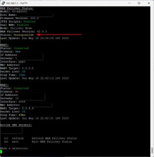

Set AMTM up for first time while using this failover script and on checking WAN Failover Status within amtm I am getting Status: Unresponsive. The other settings appear all to be ok. Does that I mean that I have some sort of a fault in my setting?
Looks like the script locked up trying to get values from NVRAM, possibly. Turn on NVRAM Checks and reload.
Thanks but not sure what NVRAM is and how to turn its checks on.
I have had to "Restart WAN Failover" from amtm and after a couple of minutes of "waiting for wan failover to restart from Cron job", it seems to be working now. Not sure if I would have to go through this process every time router is restarted.
Edit: Spoke to early as went back to "unresponsive" very shortly after showing that it was monitoring.
I have managed to enable NVRAM check and restarted script but with exactly the same problem: Status first shows failover monitoring for a couple of minutes before changing again to unresponsive. I have tried uninstalling and reinstalling to no avail. Not sure what the problem is!

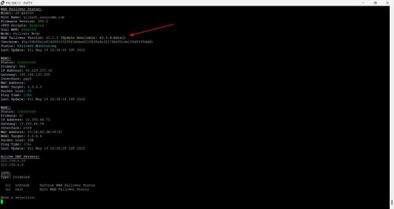

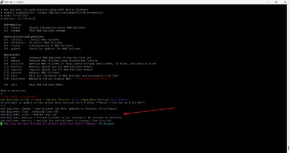

I would love to try the beta update but it is just not updating for some reason. Any idea where I am going wrong here?
You have to restart the existing instance of the status page / menu for it to use the updated version.
Thank you very much for the rapid reply but the status page was only started from afresh after the update was supposedly completed (I have put the screenshots in the right order). Is there anything else I can try? Do I need to restart the router (not preferrable unless absolutely necessary)?
Loaded fresh from a clean terminal or or from the SSH UI Menu? Needs to be a clean load.
Thanks again and sorry to be a pest but tried a clean terminal and also a fresh script install directly from SSH and again via amtm to no avail. I am stuck with 2.0.3 for some odd reason.
