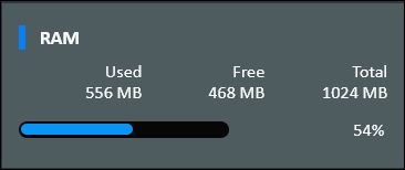

Has anyone noticed a drop in nvram usage after the Entware update?
