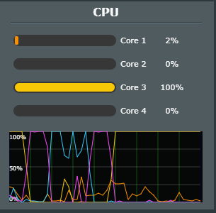

Now it's working, the CPU is working hard, but the temperatures on my AX88U are not too bad. I'll let it run for a while and see how they rise.
Temperatures 2.4 GHz: 49°C - 5 GHz: 49°C - CPU: 80°C
working fine, with similar results for me on AX88U
question is why it is written in this way, that it is occupying the whole CPU. Suricata is working in a different way.
I checked the impart on my DOCSIS connection and there is no measurable difference between Suricata vs. Snort in download and upload speeds. Also the temperature is stable at around 80C, even with some stress tests. It looks like the AX88U can easily handle Snort.
This may get missed in this guide but the assumption is that AiProtect must be disabled when installing Snort? Any thoughts on co-existence with Skynet?
Are there any other requirements to follow prior to installing?

admin@RT-AX88U-F810:/tmp/home/root# cat /proc/meminfo
MemTotal:         903572 kB
MemFree:           27944 kB
MemAvailable:      42108 kB
Buffers:            1172 kB
Cached:            56272 kB
SwapCached:        28760 kB
Active:           172996 kB
Inactive:         227640 kB
Active(anon):     150928 kB
Inactive(anon):   192544 kB
Active(file):      22068 kB
Inactive(file):    35096 kB
Unevictable:           0 kB
Mlocked:               0 kB
SwapTotal:       2097148 kB
SwapFree:        1853216 kB
Dirty:              3856 kB
Writeback:          9640 kB
AnonPages:        336864 kB
Mapped:            22400 kB
Shmem:               408 kB
Slab:             346960 kB
SReclaimable:      16396 kB
SUnreclaim:       330564 kB
KernelStack:        3376 kB
PageTables:         4364 kB
NFS_Unstable:          0 kB
Bounce:                0 kB
WritebackTmp:          0 kB
CommitLimit:     2548932 kB
Committed_AS:    1204876 kB
VmallocTotal:   260046784 kB
VmallocUsed:      124544 kB
VmallocChunk:   259794800 kB
admin@RT-AX88U-F810:/tmp/home/root# cat /proc/buddyinfo
Node 0, zone      DMA   1147   1527    306    147     10      4      4      2      0      1      0
admin@RT-AX88U-F810:/tmp/home/root# uptime
 15:31:16 up 8 days, 19:20,  load average: 3.86, 3.94, 3.88
ASUSWRT-Merlin RT-AX88U 384.19_0 Fri Aug 14 19:20:07 UTC 2020
admin@RT-AX88U:/tmp/home/root# cat /proc/meminfo
MemTotal: 903572 kB
MemFree: 120252 kB
MemAvailable: 150516 kB
Buffers: 1484 kB
Cached: 88000 kB
SwapCached: 860 kB
Active: 338188 kB
Inactive: 64296 kB
Active(anon): 271800 kB
Inactive(anon): 51364 kB
Active(file): 66388 kB
Inactive(file): 12932 kB
Unevictable: 0 kB
Mlocked: 0 kB
SwapFree: 2095216 kB
Dirty: 0 kB
Writeback: 0 kB
AnonPages: 312324 kB
Mapped: 28868 kB
Shmem: 10164 kB
Slab: 322528 kB
SReclaimable: 4288 kB
SUnreclaim: 318240 kB
KernelStack: 2544 kB
PageTables: 2688 kB
NFS_Unstable: 0 kB
Bounce: 0 kB
WritebackTmp: 0 kB
Node 0, zone      DMA    588    352    503    181    299    150     73     37     10      3      2
 09:40:01 up  1:50,  load average: 3.61, 3.71, 3.76
Temp is still stable at 80C
Definitely watching this thread.... good job!
in my case, temp is 85 C, but it is hot here in my city now...
and there is running transmission, skynet, unbound, enabled Flex QOS ...
