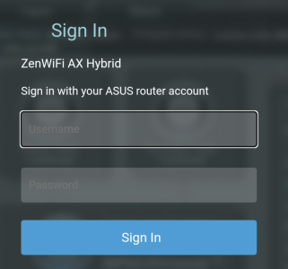

And here's your GUI

Progress! How did you get that GUI to appear, because I can't get it?
https://[v6IP]:8443 but if you have a ddns hostname that is easier.
Ping is working fine too
Progress, thank you! I've now managed to get to it, thank you for your help.
