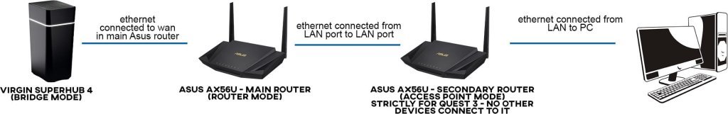

I recently bought two Asus RT-AX56U routers to have one as a dedicated router for my Quest 3 (in AP mode).

I attached a photo of how I've got it connected.

Thing is that before I replaced the routers it was all working fine with my previous RT-AC86U. Having said that I replaced one of the routers (main router if you look at the diagram I attached) - still slow speeds, then also bypassed router in AP mode - used Ethernet coupler to make direct connection from main router to my PC. Problem persisted.
I'm quite sure it's related to router configuration rather than hardware issue. But again - even with setup wizard it SHOULD work out of the box.
