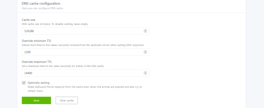

For adguardhome, You can modify the cache value here:
the default value is "4194304bytes" or "4mb" I chose "524288bytes" which is approximately 1/8th the default size. I noticed alot less strain on my RAM at this size (it is still using alot of ram, but the demand dropped). A good amount of cache typically ranges in sizes from 524288 to 2097152 bytes. The fact that AdGuardHome uses 4194304bytes is a bit overkill incomparison the the amount memory it already demands.

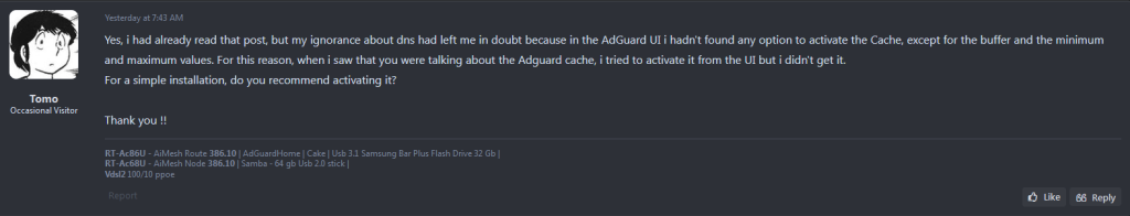

Hey,
Do you also use DNSSEC and EDNS in AdguardHome? Or just leave it alone for Unbound to work on its own?
Should I even use EDNS? Thanks
That is up to you. Unbound should use it by default since it adds additional support for larger DNS messages, DNSSEC (DNS Security Extensions), and other important DNS features, improving the overall security, performance, and functionality of your DNS infrastructure. But you shouldn't need to enable it on AdGuardHome since the requests from adguardhome to unbound are done locally. If you were sending the request to a non-local resolver (e.g. google), then yes it could be useful. If you are using more than just Unbound in your AdGuardHome upstream section, I would recommend enabling it in AdGuardHome.
