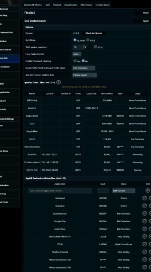

I have a WiFi6 router with latest 3.0.0.6 asuswrt-merlin fw with Flex enabled & I also have custom iptables setup. All running smoothly!
This reminds of a similar issue I was having when setting up a streaming iptable rule that was causing the router to crash (fix below):

It's working fine now without any iptables rules.
@irfan44 Any updates since removing the iptable rules?
My suggestion would be re-adding the iptable rules one by one to identify which gives you the problem (if you haven't already)

Used without ip table rules for some days and it worked without any problems.
